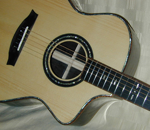

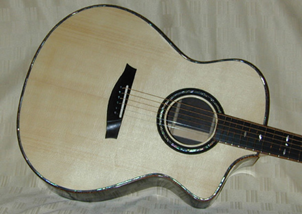

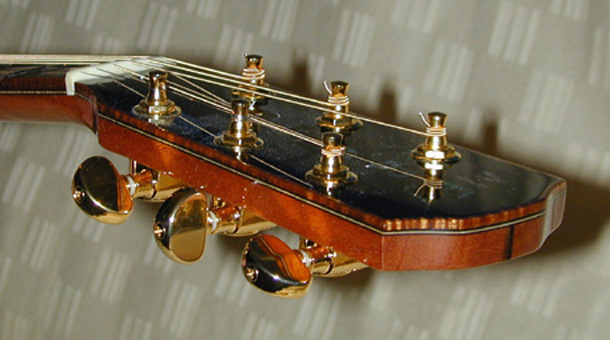

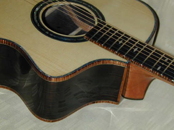

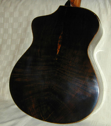

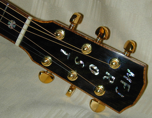

Here are some pix of a students guitar, jsut freshly strung up last night. The top is Adirondack, the back is extremely dark braz, and the sides are non booked macassar ebony, the only thing I could find a couple years back to match this awesome back set. The binding is more of the special dark curly koa, and the top is purfed in apaua. The student cut the headstock inlay himself, and the fretboard has an Andy Depaule red ab snowflake set. Bridge is african blackwood. The rosette is segmented braz with a green ab shell ring. It cant really be seen in the photo, but the ebony headplate has a wide 45 degree curl to it in some light -looks very cool. The guitar sounds very good, plenty of volume, even top to bottom (its symmetrically braced), and of course the owner/builder is very proud of his accomplishments.

Whoa! firey bindings!
Very nice!

Nice work! Somebody had a great teacher. You should be quite proud.
But no arm rest?
PostPosted: Thu Apr 20, 2006 12:20 am
Hey Paul .. no armrest, no backstrip, no back purf at all .. fairly specific ideas he had when building. Most seem to have their own aesthetics in mind - I have one who doesnt care for color inthe purf - strictly blk/white. Thsi student doesnt like florentine cuts at all, likes higher action that I do, but then he's more a strummer than fingerstylist.
I have about half my students wanting armrests, same with cutaways. All depends on the person, just like the rest of us.

Well .. the student did most of the rosette, we bent the sides together in a fox, he did all the thicknessing, most of the brace shaping, all the radiusing, cut the fret slots and fretted, dressed crowned and polished them, most of the neck set, we bound the headstock together as this is the first one I had ever done, he bound most of the rest of the guitar, he did 99 percent of the sanding and wet sanding, all the pore filling - CA on this one), rounded the binding edge, filled any gaps, all the buffing, he made the bridge shape and sanded it, drilled the pin holes, I did the slot, we mitred the binding together, he did all the headstock inlay and fretboard inlay, I chiselled the lacquer off for the FB and bridge - he didnt want to touch it once we got that far (cant blame him really !!!!!). He made the kerfing, shaped most of the neck, radiused and levelled the FB. He inlaid most of the shell, I had to make a couple pieces for the sharper bend of the venetian as the straight pieces jsut wouldnt look right, other htan that they are all straight 1/16 paua from Depaule. We sprayed together, I shot most of the coats because at one night a week it woudl have taken forever - so when I was shooting somehting else I just hit it with a coat. He did the level sanding after the first ten, then we shot 4 more. Final finish thickness at the bridge was about 8 thou.
So it took about 14 months, (one just for inlay stuff)but the first 3 were only every other week. there will be another post tomorrow, the student who was opposite him those first weeks will be done tonight. Its a signature cutaway in birdseye maple, bearclaw spruce, armrest, florentine, shell top purf .. well you will just have to wait and see !!!!
